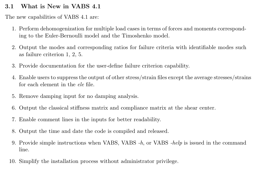

Thanks, Su - I have VABS 4.0, per the manual. Do you know when 4.1 will be pushed out through Altair? Where can I find a copy of the 4.1 manual? I’d like to understand what else changed between 4.0 and 4.1.
Here is the change log
