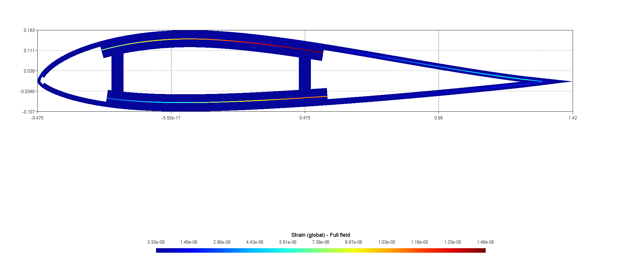

Good morning/afternoon, teachers. During the stress recovery process, I observed that the strain exhibits a significant gradient along the thickness direction of the airfoil, which normally should not occur.

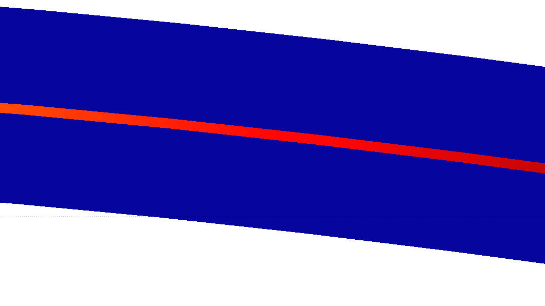

翻译:这是应变梯度很大区域放大图
This is an enlarged view of the area with a significant strain gradient.

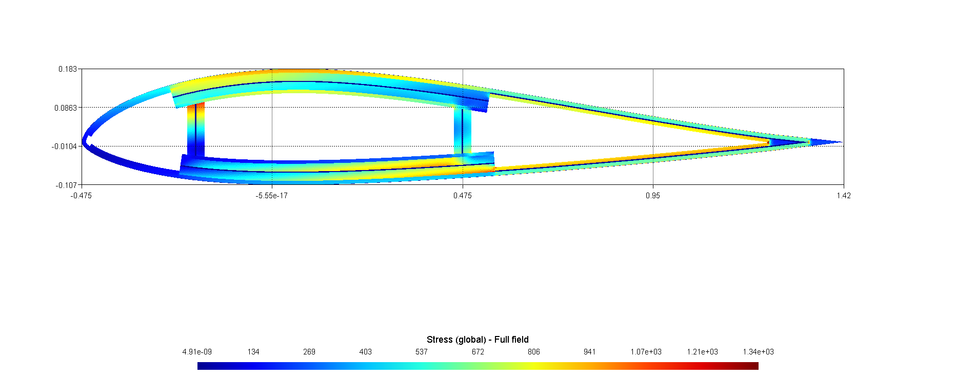

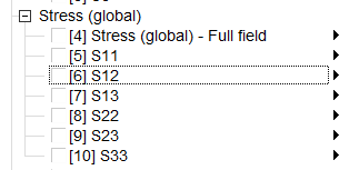

The plot you attached here is for stress, not strain. You can go to the left panel of gmsh to switch between different stress/strain components.

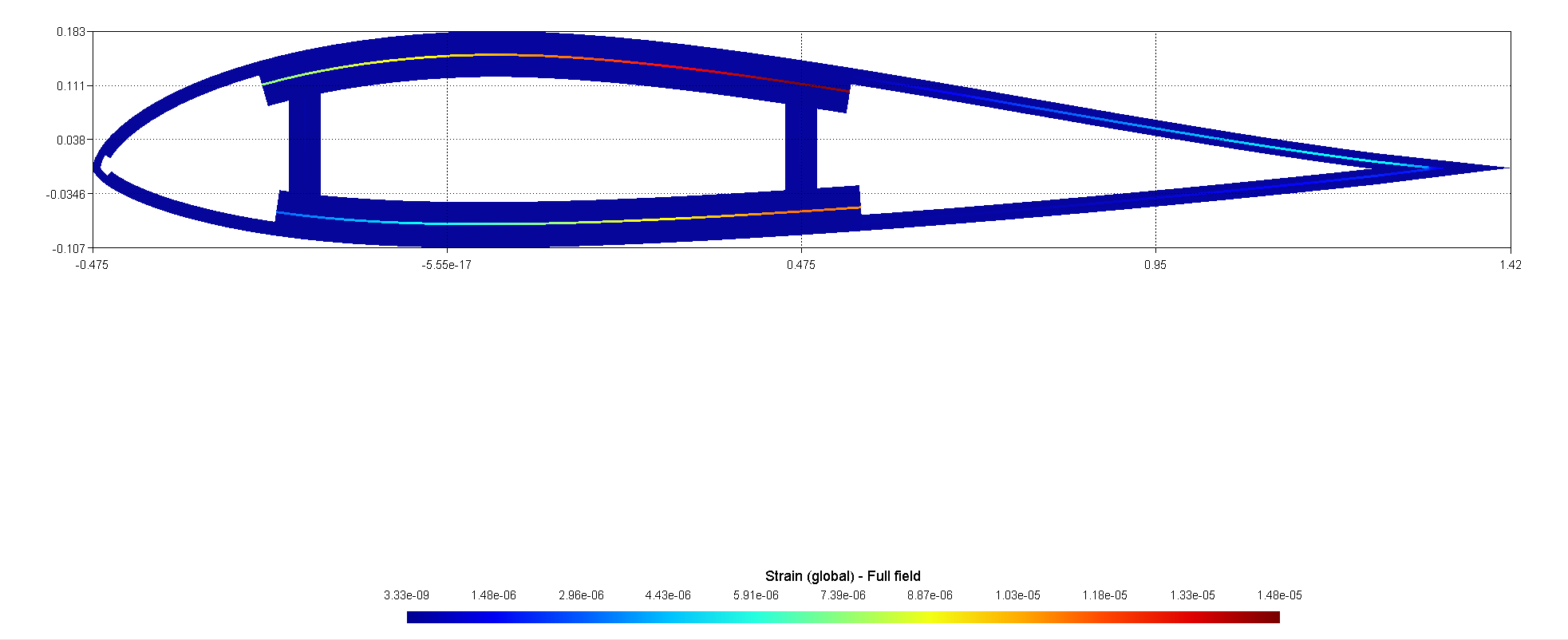

I am very sorry, I made a mistake. This should be the graph corresponding to strain.
This is the strain distribution diagram for the various local regions of the airfoil.

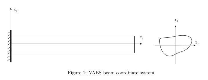

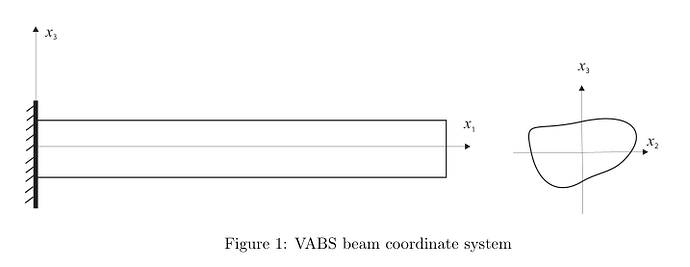

Additionally, I would also like to ask what directions these stresses represent.
What are the versions of PreVABS and VABS you are using?
You can check the manual for more details.
