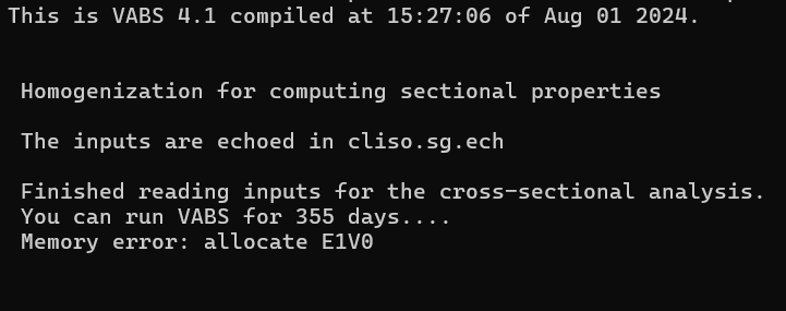

Hello,
I am encountering a memory allocation error while running the Vlasov model in VABS. Could you please advise on how this issue can be resolved?
I have uploaded the input file (.sg) and the corresponding echo file (.ech) in the link for your review.
vlasov files
Thank you for your assistance.
After some debugging it looks like when we have both initial_curvature flag and vlasov_flag β€œon” simultaneously i end up getting the above error.
But if i turn off my initial_curvature flag in VABS, I get the 5x5 vlasov refined matrix without any error. Is there any work-around to incorporate both the flags together? Thanks!
Sorry for delayed response. It was a bug discovered some time ago. I will send you the updated code via email. It is also fixed on our server.
